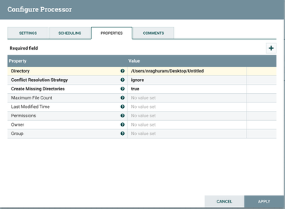

I used GetFTP processor to get a CSV file from filezilla and transferred it to a PUTFILE. it worked but when I open the directory where I wanted the file to save in laptop. It's not there.
Explorer
As you can see the 3 mb got transferred in screenshot - 1. And in the screenshot -2 I am specifying my Path where I want it stored. I basically want the CSV file written in the untitled text file. Am I doing it right.? I very new to NIFI. Please Help..:

Hi @Shailesh Nookala, PutFile processor Writes the contents of a FlowFile to the local file system.
1.You can find the file in NiFi running nodes only as the property create missing directories is true, NiFi will creates those directories for you and store the csv file into your directory(i.e /Users/nraghuram/...).
Example:-
1.Lets take you are having 2 NiFi nodes(E01,E02) and you are running GetFile processor on only primary node(consider E02 is primary), so when you run on primary node then the File got stored in the specified directory of your processor on primary node(in our case on E02 because it is primary node).
2.In this example im having E02 is primary node and running PutFile processor to store File in local directory.
3.As Highlighted below the File is on E02 node
4.When i store the file it is inside /d1 directory on E02 node only because i'm running GetFile only on Primary Node.
