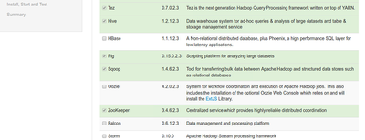

I was installing sqoop on a node but it failed due to repository error. It's actually not installed but displays on Ambari UI as in pic. No option to install again through +Add Service. How to remove it from Amabri to install again?

Did you try using the Ambari UI "Sqoop" --> "Service Actions" --> "Delete Service" option to delete Sqoop client ?
Else you can try the Ambari API approach as well to delete the sqoop as following:
curl -iv -u admin:admin -H "X-Requested-By: ambari"  -X DELETE http://${AMBARI_HOSTNMAE}:8080/api/v1/clusters/Sandbox/services/SQOOP

Hello Jay. where is these tabs you mentioned: Sqoop" --> "Service Actions" --> "Delete Service.

Ambari API worked for me. Thanks for the help.

Once the "sqoop" service is deleted then you should be able to install it again using "Add Service".
