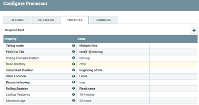

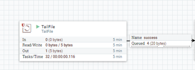

Hi @Eric Lloyd, can you once try to configure processor as
what i have tried is:-
i have created 2 directories in my
/tmp
as test1 and test2
and did
echo "test">/tmp/test1/test.log
echo "test">/tmp/test2/test.log
and in the processor i configured Files to tail property as
test[1-2]/test.log
it will look for both test1 and test2 directories
Rolling filename strategy(not required) as test.log as my file names are always test.log
Base directory is /tmp
i mentioned as Fixed name as Rolling strategy and Recursive lookup true
As this processor picks up new data and stores the state for each directories.
/tmp
as test1 and test2
and did
test[1-2]/test.log

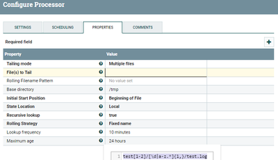

Thanks for the answer but maybe I should have clarified. This solution works for my testing environment but my final environment is actually monitoring the versions directory... so it won't always be test1 and test1 but rather
../versions/123.1
.../versions/234.2
and then a new version will be added that is an unknown number. So that is why I was hoping to use a wildcard like: *
Can I use a wildcard? It seems you are using an expression language, maybe with /versions/[*]

@Eric Lloyd, for this case make we cannot mention wild cards like [*] as this processor wont accepting those regex.
change FilestoTail property to
test[1-2]/[\d|a-z.*]{1,}/test.log
Expression Explanation:-
test[1-2] --look for  test1 or test2
Then property expression check for
[\d|a-z.*]{1,} --check for directory name as having digits or letters more than one time
and lists all those directories recursively.
Configs:-
For your case:-
Files toTail property should be some thing like below
versions/[\d|a-z.*]{1,}/<your-log-file-name>
