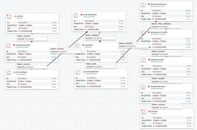

i'm on the tutorial 'ANALYZE TRAFFIC PATTERNS WITH APACHE NIFI', unfortunately i'm having a problem, nifi can't access the repository where my data is.
Here is the general schema:

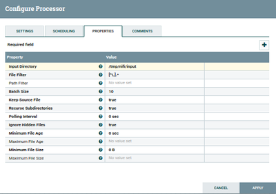

The processor configuration.

The file path in GetFile configuration is referring to the local file path where the NiFi instance is installed. Your screenshot showing /tmp/nifi/input is on HDFS, not the local OS.
Please create /tmp/nifi/input on the linux OS where nifi is installed and place your data in there. Your GetFile processor, as configured, will find it there.
