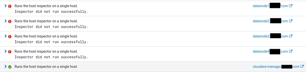

i have installed CDH-6.3.0 , with 5 nodes (Cent os 7) but after installing cloudera manager when i tried to inspect all hosts it only ran on one host as you see below
here is inspect validation results

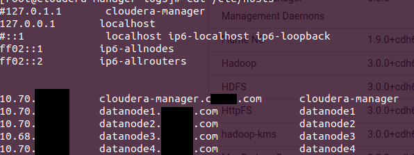

And here is /etc/hosts file for server and one of the agents

@dv_conan Make sure the agent is heart beating in the CM > Hosts > All hosts page.
Then check the agent logs (/var/log/cloudera-scm-agent/cloudera-scm-agent.log) and see if there is any error.

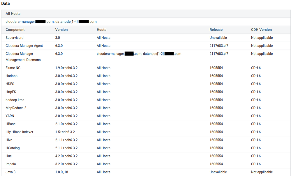

@dv_conan The error is due to missing class form the agent.
Error: Could not find or load main class com.cloudera.cmf.inspector.Inspector
You have to install again and do a restart.
yum install cloudera-manager-daemons
service cloudera-scm-agent restart
This should resolve the issue.
