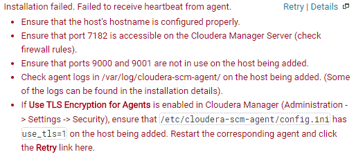

Installation failed. Failed to receive heartbeat from agent.
Ensure that the host's hostname is configured properly.
Ensure that port 7182 is accessible on the Cloudera Manager Server (check firewall rules).
Ensure that ports 9000 and 9001 are not in use on the host being added.
Check agent logs in /var/log/cloudera-scm-agent/ on the host being added. (Some of the logs can be found in the installation details).
If Use TLS Encryption for Agents is enabled in Cloudera Manager (Administration -> Settings -> Security), ensure that /etc/cloudera-scm-agent/config.ini has use_tls=1 on the host being added. Restart the corresponding agent and click the Retry link here.
I don't why below image is not visible other it is public also.It is for same error above.

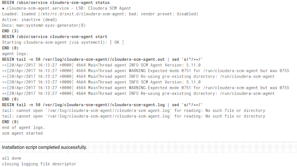

Starting Cloudera Manager Agent...
BEGIN /sbin/service cloudera-scm-agent status
● cloudera-scm-agent.service - LSB: Cloudera SCM Agent
Loaded: loaded (/etc/rc.d/init.d/cloudera-scm-agent; bad; vendor preset: disabled)
Active: inactive (dead)
Docs: man:systemd-sysv-generator(8)
END (3)
BEGIN /sbin/service cloudera-scm-agent start
Starting cloudera-scm-agent (via systemctl): [ OK ]
END (0)
agent logs:
BEGIN tail -n 50 /var/log/cloudera-scm-agent//cloudera-scm-agent.out | sed 's/^/>>/'
>>[20/Apr/2017 16:13:27 +0000] 4664 MainThread agent INFO SCM Agent Version: 5.11.0
>>[20/Apr/2017 16:13:27 +0000] 4664 MainThread agent WARNING Expected mode 0751 for /run/cloudera-scm-agent but was 0755
>>[20/Apr/2017 16:13:27 +0000] 4664 MainThread agent INFO Re-using pre-existing directory: /run/cloudera-scm-agent
END (0)
BEGIN tail -n 50 /var/log/cloudera-scm-agent//cloudera-scm-agent.log | sed 's/^/>>/'
tail: cannot open '/var/log/cloudera-scm-agent//cloudera-scm-agent.log' for reading: No such file or directory
END (0)
end of agent logs.
scm agent started
Installation script completed successfully.
all done
closing logging file descriptor

It is missing the cloudera agent log at /var/log/cloudera-scm-agent//cloudera-scm-agent.log
Make sure it is created and writable by the user running the CM agent process. This may not fix it but will give us the log to look at.
It also gives a warning about the /run/cloudera-scm-agent being in mode 755 instead of 751. You could try correcting that manually although I don't think this is the issue.

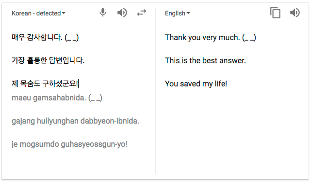

매우 감사합니다. (_ _)
가장 훌륭한 답변입니다.
제 목숨도 구하셨군요!
Community Manager
Of course I wondered what @KamaJinny was saying so I figured others may as well. Here is the translation via google translate:
