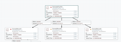

I think it's better to go with 3 convert record processors in parallel with same JsonReader(as the json content is same for all) and different JsonSetWriters(we need different elements in each file) to get 3 different files i.e
Customer_Id,Brand_Nm,BarCode_No,Offer_Ds,Offer_Expire_Dt(convertrecord1)
Customer_Id,Assignment_id,Assign_Dt,Offer_Nm(convertrecord2)
Customer_Id,Address_Line_1,Address_Line_2,City,State_Cd,Postal_Cd,Vendor_Desc,Offer,Source(convertrecord3)
Flow:-
As input json object/message having nested arrays i have used jsonpathreader controller service and added avro controller service and added all the user defined properties with matching json expressions. this reader will be same for all the three Convertrecord processors.
in JsonSetwriter controller service i have used schema text property to define our required schema.
i tried with one ConvertRecord processor and attached .xml for reference, you can save and add your required elements as per your requirements.
Let us know if you have any issues..!!
178185-hcc.xml

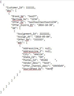

Super Guru
@Saikrishna Tarapareddy
I tried a load test of 500k records
input:-
"Customer_Id": 11111,
"dsc": [{
"Brand_Nm": "test",
"qa": [{
"Assignment_Id": 22,
"addr": [{
"AddressLine_1": null,
"City": "Amelia"
I repeated the above message for 500k records and used convert record processor it got completed in 5 sec.
In your case you will have record size is more but still if you are having enough heap space, convert record will work without any issues..!!
Could you please share 10 records that having multiple addresses for a customer and the expected output so that i can try on my end.
