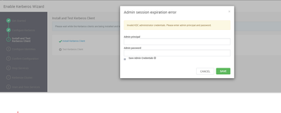

Hallo,
When to enable Kerberos via ambari, I am facing the following window popup at the time of Testing client after client installation saying
in my log ambari-server listed below
2024-06-04 06:27:43,380 WARN [agent-report-processor-2] ActionManager:162 - The task 76 is not in progress, ignoring update
2024-06-04 06:27:43,861 INFO [ambari-client-thread-6248] AmbariManagementControllerImpl:4086 - Received action execution request, clusterName=hadoop, request=isCommand :true, action :null, command :KERBEROS_SERVICE_CHECK, inputs :{HAS_RESOURCE_FILTERS=true}, resourceFilters: [RequestResourceFilter{serviceName='KERBEROS', componentName='null', hostNames=[]}], exclusive: false, clusterName :hadoop
2024-06-04 06:27:44,149 WARN [ambari-client-thread-6248] KDCKerberosOperationHandler:329 - Failed to kinit as the KDC administrator user, admin/[email protected]:
ExitCode: 1
STDOUT:
STDERR: kinit: Server not found in Kerberos database while getting initial credentials
2024-06-04 06:27:44,151 ERROR [ambari-client-thread-6248] KerberosHelperImpl:2507 - Cannot validate credentials: org.apache.ambari.server.serveraction.kerberos.KerberosAdminAuthenticationException: Invalid KDC administrator credentials.
The KDC administrator credentials must be set as a persisted or temporary credential resource.This may be done by issuing a POST (or PUT for updating) to the /api/v1/clusters/:clusterName/credentials/kdc.admin.credential API entry point with the following payload:
"Credential" : {
"principal" : "(PRINCIPAL)", "key" : "(PASSWORD)", "type" : "(persisted|temporary)"}
2024-06-04 06:27:44,152 ERROR [ambari-client-thread-6248] CreateHandler:80 - Bad request received: Invalid KDC administrator credentials.
"Credential" : {
2024-06-04 06:27:44,578 WARN [agent-report-processor-1] ActionManager:162 - The task 75 is not in progress, ignoring updatecan anyone help me, please..

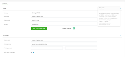

Created on 06-05-2024 05:38 PM - edited 06-05-2024 05:39 PM
@Majeti . my issue is when Ambari tests Kerberos client always shows a dialog box like this
My previous settings were like this
I have the principal admin/[email protected] and the password is correct,

Created 06-06-2024 12:20 AM
Hi @rizalt , I am not sure if you are hitting this known issue https://docs.cloudera.com/runtime/7.1.2/release-notes/topics/rt-known-issues-ambari.html . You can try the workaround mentioned here for now.
Created 06-06-2024 12:12 PM
@rizalt
Did you see the same entry in the krb5.conf that I suggested you add?
[domain_realm] .hadoop.com = HADOOP.COM hadoop.com = HADOOP.COM
In the Kerberos setup UI you should also include
HADOOP.COM , . HADOOP.COM Check a solution I offered
Error while enabling Kerberos on ambari
Hope that helps
