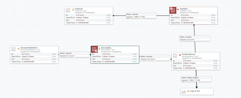

Frequent Visitor
Thank you so much for your clear response. As I am new to Nifi, my flow looks like the following:
My primary concern is to ensure that the entire NiFi flow runs successfully without any errors and that all data extracted from the database table is accurately written to HDFS. The reason behind this concern is that I want to trigger a Spark job using a scheduler such as Apache Airflow immediately after the data ingestion process completes.
- Flow Overview
- GenerateTableFetch -> ExecuteSQL -> PartitionRecord -> PutHDFS -> PutEmail
Specific Concerns:
1. Flow Completion:
- Error-Free Execution: How can I ensure that the entire flow runs without any errors from start to finish and if any error occurred I want to be able to see in the logs enventually in the airflow logs?
- Verification of Data Written: How can I confirm that all the data extracted from the table is successfully written to HDFS?
2. Integration with Scheduler:
- Triggering Spark Job: What are the best practices to trigger a Spark job in Apache Airflow right after confirming that the data ingestion process has completed successfully?
Thank you for your assistance!
Master Mentor
@mohammed_najb
  1. It is impossible to guarantee a flow will always run error free. You need to plan and design for handling failure.  How are you handling the "failure" relationships on your ExecuteSQL and putHDFS processors?
  2. The PutHDFS will either be successful or route FlowFile to failure relationship r rollback the session.  NiFi does not auto remove FlowFiles.  It is responsibility of dataflow designr to handle failures to avoid dataloss.  For example, do not auto-terminate any component relationships where FlowFile may get routed.
  3. I don't know what would be the "best practice" as that comes with testing. Since you are using GenerateTableFetch processor, it creates attributes on the output FlowFiles.  One of which is "fragment.count".  You could potentially use this to track that all records are written to HDFS successfully.   Look at UpdateAttributes stateful usage options.  This would allow you to setup RouteOnAttribute to route last FlowFile once stateful count equals "fragement.count" to a processor that triggers your Spark job.
Just a suggestion, but others in the community may have other flow design options.
