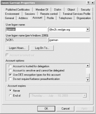

If your KDC is an AD server, then your AD administrator must enable the “Do not require Kerberos pre-authentication” checkbox in the user properties of the newly created impala principal. Refer the attachment.
