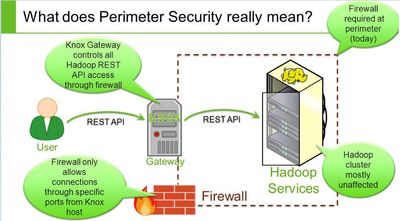

Below on the knowGateway is installed all the client software, the Hadoop services here represent the Master and Slaves nodes.
The Knox gateway should sit on the Edge node as should be the only access to the cluster as illustrated above.

@Anpan K Yes, Knox should be accessible to external users, so it has to be installed on node which can be access from outside the cluster. Like an edge node. This node can be still be managed by ambari.
