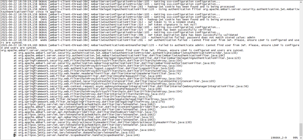

Knox SSO SAML for Ambari have a prompt:
Alternatively login as an Ambari local user using the local login page.
http://example.com:8080/#/login/local
ambari-server log:

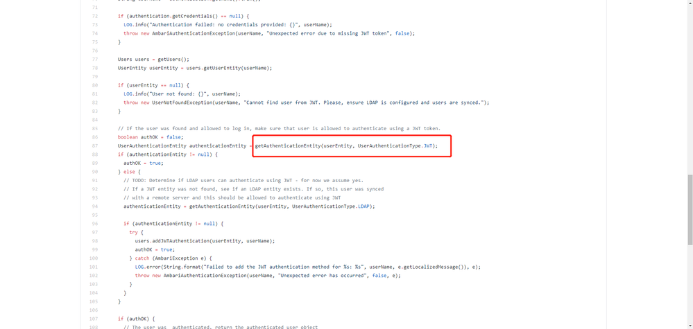

thank you, it is not synced with ldap/Ad and lgoin success. But i have a doubt that ambari authentication type include JWT, how can i sync the JWT to table 'user_authentication'

Yes, it is exist a hadoop-jwt cookie and i tested with the local admin user. I debug this class AmbariJwtAuthenticationProvider follow:
I only know sync the table ‘user_authentication’ with command sync-ldap, i can not find the way update authentication type JWT into the table 'user_authentication'
