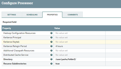

Example:-
lets for example i have shared configs for ListHDFS processor below.
This processor requires Hadoop Configurations Resources to run but they are not Mandatory properties.
if you won't mention hdfs-site.xml,core-site.xml in Hadoop Configurations Resources, this processor results same error as you shared above.
Like this way you need to figure out what are all the configurations you need to mention in ListenUDP processor as they are not Mandatory properties. Those missing properties will also results to same error as you are having now.

Example:-
