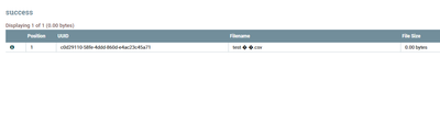

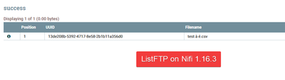

I have upgraded nifi from 1.16.3 to 1.21.0
Now, the processors ListFTP, FetchFTP, PutFTP won't work with filenames that contains french accents like à é etc..
It worked like a charm on Nifi 1.16.3

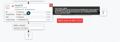

I do not think that your problem is related to the name itself and/or the characters. Your error messages states clearly that you do not have the required permissions to extract the file. If there would have been an issue with the name, you would have received an error message stating that the file cannot be found in that location. Make sure that you have all the configurations done properly to be able to access that ftp location.

I have tested with same ftp account on the nifi version 1.16.3 and 1.21.0. It works perfectly fine on 1.16.3.
FetchFtp gives the permission error because filename fetched from listftp contains characters (black question marks)
I can assure that the there is no problem concerning the permissions. with the Nifi 1.21.0, i fetched the files without special characters in the filename.

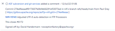

I recommend reading through the comments, suggestions, and troubleshooting done within the following Apache NiFi Jira to see if you are encountering similar observations.
https://issues.apache.org/jira/browse/NIFI-10143
If so, it may be best to create a new Apache JIra for your specific character set issues to see what the committer community can do for you.

It seems that the following commit in the version nifi 1.17.0 have somehow broke the recognition of french characters :
 to test it, i downloaded nifi 1.17.0 and ran the tests, got the following result
I will create a Apache Jira ticket.
