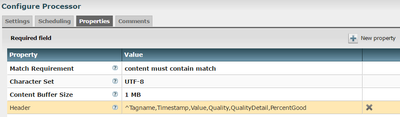

@mclark,
Ok , but RouteOnContent checks for the string in the whole file. where as i want to compare only the firstline .
if i have my RouteOnContent like below..it would route files to "Header" even if the data satisfies the RegEx.

Your Regex above says the CSV file content must start with Tagname,Timestamp,Value,Quality,QualityDetail,PercentGood
So, it should not route to "Header" unless the CSV starts with that. What is found later in the CSV file should not matter. I tried this and it seems to work as expected. If i removed the '^', then all files matched.
Your processor is also loading 1 MB worth of the CSV content for evaluation; however, the string you are searching for is far fewer bytes. If you only want to match against the first line, reduce the size of the buffer from '1 MB' to maybe '60 b'. If I changed the buffer to '60 b' and removed the '^' from the regex above, only the files with the matching header were routed to "header". Thanks,
