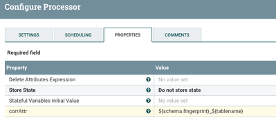

If you want your correlation attribute name to be more unique, you can use the updateAttribute processor before the MergeContent to create something more unique based on both ${schema.fingerprint} and ${tablename}.
for example:

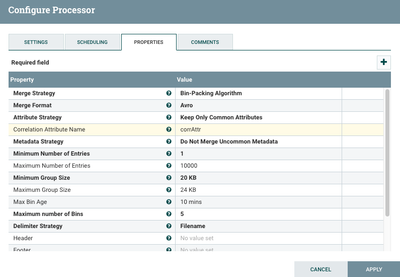

followed by MergeContent configured similar to below:
You understanding of my original explanation was correct. That could also explain missing attributes since all Flwofile without the attribute would end up in same bin and only matching attributes would be retained on merged FlowFiles.
