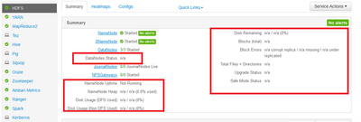

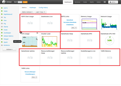

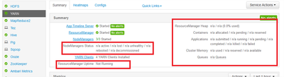

I have lost information in ambari as shows the following images:
If I check the logs of ambari-server.log I find a lot of entries with this message:
01 Feb 2017 12:41:47,167  WARN [ambari-metrics-retrieval-service-thread-1] RequestTargetAuthentication:88 - NEGOTIATE authentication error: No valid credentials provided (Mechanism level: No valid credentials provided (Mechanism level: Attempt to obtain new INITIATE credentials failed! (null)))
01 Feb 2017 12:41:47,169 ERROR [ambari-metrics-retrieval-service-thread-1] AppCookieManager:122 - SPNego authentication failed, can not get hadoop.auth cookie for URL: http://hadoop01.int:50070/jmx?get=Hadoop:service=NameNode,name=FSNamesystem::tag.HAState
01 Feb 2017 12:41:47,168  WARN [ambari-metrics-retrieval-service-thread-0] RequestTargetAuthentication:88 - NEGOTIATE authentication error: No valid credentials provided (Mechanism level: No valid credentials provided (Mechanism level: Attempt to obtain new INITIATE credentials failed! (null)))
01 Feb 2017 12:41:47,170 ERROR [ambari-metrics-retrieval-service-thread-0] AppCookieManager:122 - SPNego authentication failed, can not get hadoop.auth cookie for URL: http://hadoop01.int:8088/jmx
I have tried to regenerate the keytab but the problem persists.
I can access these url with my browser using both, kerberos ticket or AD windows ticket without any problem.
Any clue about what maybe happening?
Thank you in advance
