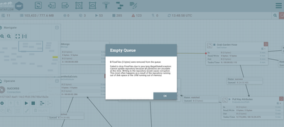

I had a lot of queue up messages in a few place on a single 8G Node of HDF 2.0 and couldn't empty the queues.

I shut down the server, made sure the memory was clear. I upped the memory in bootstrap.conf and made sure all the heavy duty processors (Twitter) were stopped. Then on restart I went to the ones I wanted to empty and was able to do so. Once all that junk was out memory, everything worked flawless. I think my server was a bit undersized for what I was doing. I was running all the tweets from Strata through TensorFlow, Python Vader, saving images, maybe 50 processors plus a few demos I was running simultaneously.

Master Mentor
@Timothy Spann
Looks like you do not have enough file handles
The following command will show your current open file limits:
# ulimit -a
This should be min 10000, but may need to be even higher depending on the dataflow.
Matt
Master Guru
it was unlimited!?!??! I restarted NIFI and was able to do it. Probably too much in JVM memory and a wrong message?
Master Guru
