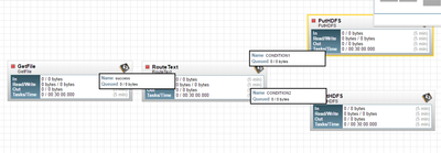

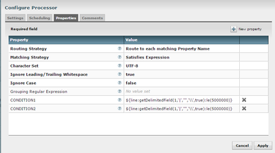

Is this performance exhaustive or there is any way to improve the performance further in this standalone server considering the server has 4 cores and 16 GB RAM.
Also as I can observe most the processing time is consumed by the RouteText processor. Is this design suitable for this kind of use case to send the records of a pipe delimited file to different outputs based on some conditions since RouteText processes records line by line. We are using NIFI 0.6.1

Created 09-06-2016 04:14 PM
According to you the flow should look like
GetFile->SplitFile->RouteText->PutHDFS
Since we are using only a standalone cluster if we Split the file into 5000 splits do we need to do a UpdateAttribute/MergeContent after the RouteText processor or the flow shown above should be fine?

Created on 09-06-2016 02:03 PM - edited 08-19-2019 01:41 AM
You have a couple things going on here that are affecting your performance. Based on previous HCC discussions you have a single 50,000,000 line file you are splitting in to 10 files (Each 5,000,000 lines) and then distributing those splits to your NiFi cluster via a RPG (Site-to-Site). You are then using the RouteText processor to read every line of these 5,000,000 line files and route the lines based on two conditions.
1. Most NiFi processors (including RouteText) are multi-thread capable by adding additional concurrent tasks. A single concurrent task can work on a single file or batch of files. Multiple threads will not work on the same file. So by setting your current tasks to 10 on the RouteText you may not actually be using 10. The NiFi controller also has a max number of threads configuration that limits the number of threads available across all components. The max thread setting can be found by clicking on this icon in the upper right corner of the UI. Most components by default use timer driven threads, so this is the number you will want to increase in most cases. Now keep in mind that your hardware also limits how much "work" you can do concurrently. With only 4 cores, you are fairly limited. You may want to up this value from the default 10 to perhaps 20. You can just end up with a lot of threads in cpu wait. Avoid getting carried away on your thread allocations (Both at the controller level and processor level).
2. In oder to get better multi-thread throughput on your RouteText processor, try splitting your incoming fie in to many smaller files. Try splitting your 50,000,000 line file in to files with no more then 10,000 lines each. The resulting 5,000 files will be better distributed across your NiFi cluster Nodes and allow the multiple threads to be utilized.
