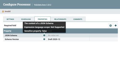

The schema can change per flow file, so I want to derive it from flow file attribute and then use it as ${schema}. In the ValidateJSON 1.23.2 processor, the schema can't be derived from EL.

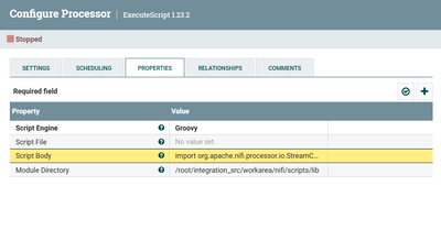

This is my setup:
ls /root/integration_src/workarea/nifi/scripts/lib
json-20231013.jar  org.everit.json.schema-1.14.3.jar
I am getting this error now:
ExecuteScript[id=58d580dd-019a-1000-4e36-7b54d5c2d161] Processing failed: org.apache.nifi.processor.exception.ProcessException: javax.script.ScriptException: org.codehaus.groovy.control.MultipleCompilationErrorsException: startup failed:
Script5.groovy: 15: unable to resolve class org.everit.json.schema.loader.SchemaLoader
 @ line 15, column 1.
   import org.everit.json.schema.loader.SchemaLoader
Script5.groovy: 16: unable to resolve class org.everit.json.schema.ValidationException
 @ line 16, column 1.
   import org.everit.json.schema.ValidationException
Script5.groovy: 17: unable to resolve class org.everit.json.schema.Schema
 @ line 17, column 1.
   import org.everit.json.schema.Schema
3 errors
Any idea on how to resolve the error?
