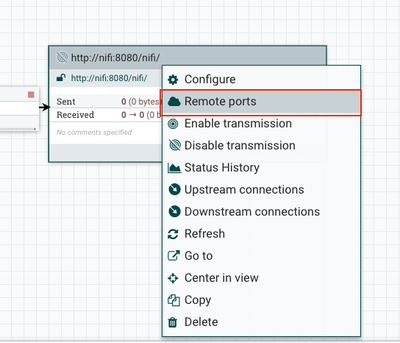

I setup RPG and an Input Port.
It seems RPG can connect the remote nifi instance.
However, when I click Manage Remote Ports, it can't display the input port I added.
BTW, I use a secured 3 node cluster with S2S enabled.
Please see the attached screenshot.
Did I miss anything?
Thanks.

Hi @Alvin Jin
Happy that this information was helpful.
Yes, you need to add your input port at the root canvas. If you need to work with process group, you still need to have an input port at root, then add an input port in your process group, then connect your root input port with process group:
If you have recursive process groups you should do the same thing to connect your external input port until your internal process group.
Regarding data distribution, you should know that S2S do batching of data to have better performance. So it tries to send maximum data to one node before moving to the next one. This is very efficient. But if you have few flows (when testing for example) all flow files will go to a single node.
Mainly S2S open a connection to a node and try to send data for x miliseconds. If this time is not enough it moves to the next node. Other parameters are flow file count and size.
These parameters can be defined globally. In the last versions of NiFi you can define these parameters at each input port level which is very convenient. I show you how to configure this below (red instructions)

Master Mentor
@Alvin Jin
NiFi Remote Input and Output Ports can only be added to the root canvas level. Based on the screen shot you provided above, you have created your "sftp" input port in sub process group.
Input and output ports exist to move FlowFIles between a process group and ONE LEVEL UP from that process group only. Input ports will accept FlowFiles coming from one level up and output ports allow FlowFiles to be sent one level up. You can only move FlowFiles up or down one level at a time.
At the top level of your canvas (root process group level) adding input or output ports provides the ability for that NiFi to receive (input port) FlowFiles from another NiFi instance or have another NiFi pull files from (output port) that NiFi. We refer to input and output ports added the top level as remote input or output ports. While the same input and output icon in the UI is used to add both remote and embedded input and output ports, you will notice that they are rendered differently when added to the canvas.
