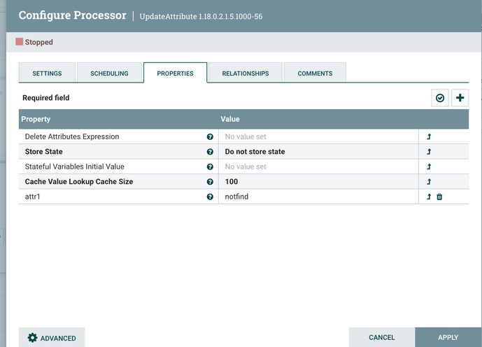

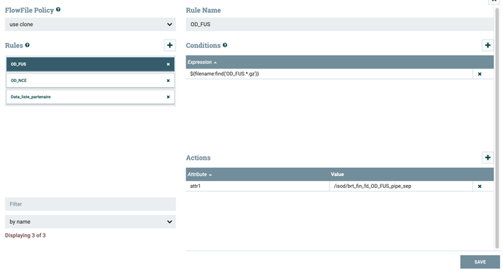

This use case can easily be handled by a single UpdateAttribute processor through the use of the "Advanced" functionality without needing to develop and manage a python script. The "Advanced" functionality  works like an If/Then/Else.
Would look something like this:
Outside the "Advanced" UI is the Else.  Any dynamic attributes add here are added to FlowFile only if the same attribute was NOT added by a rule in the "Advanced" section.
So here you set attr1 = "notfind".
Inside the "Advanced" section you create one or more rules.  Each rule has a Conditon (If) and an Action (then) sections.  If the condition NEL resolves to "true" then actions are applied to FlowFile.  So you set up a rule for each flowfile filename type. If none of teh rules match then the default attr = notfind is set.
