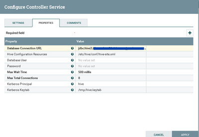

Here is the Database Connection URL:
jdbc:hive2://host.name.net:10000/;principal=hive/_HOST@EXAMPLE.COM

2 things Resolved the issue:
1. start with the "jdbc:hive2" prefix
2. Add following property to hive-site.xml that is passed under HiveConnectionPool "Hive Configuration Resources" property.
<property> <name>hadoop.security.authentication</name> <value>kerberos</value> </property>
