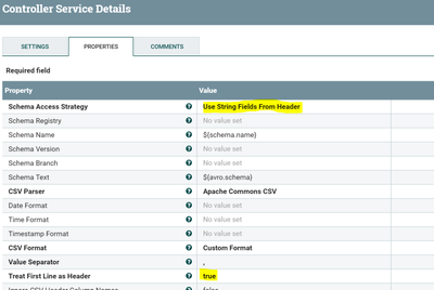

As your data having Header so use Csv reader use
Then use UpdateRecord processor with

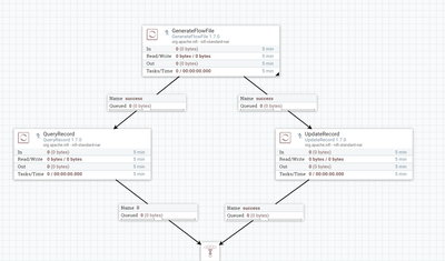

I tried some simple flow using both processors, Use the attached flow xml as a reference and change per your case
222899-updaterecord-queryrecord.xml

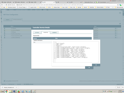

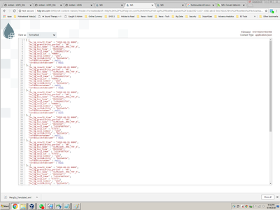

Data coming in ConvertRecord from CSV to AVRO schema.
Avro_Schema
Outgoing Data
As you can see, incoming data have column name in different format. I changed the Avro Schema to reflect the same column name format but then it loaded NULL values in all the columns.

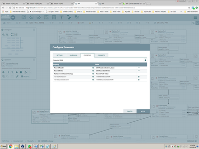

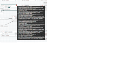

UpdateRecord Error: Can not write to schema, schema is unknow.

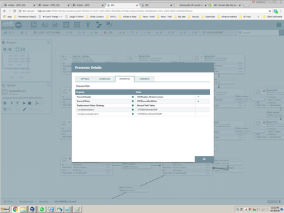

UpdateRecord Properties

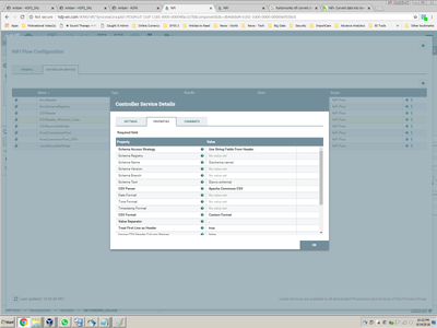

CSV Reader
CSV Writer

In your CSVSetWriter controller service configure as
in Schema Text Property define new schema i.e. avro schema with lowercase field names.
Let us know if you are having any issues..

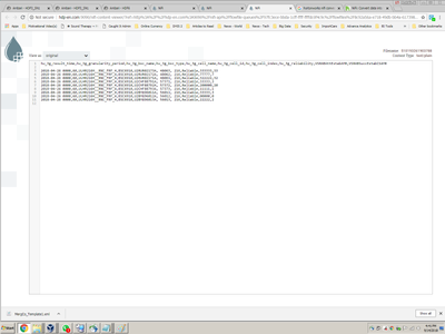

It got successful but out out was empty.
Source Header: Aim is to convert mentioned last 2 columns in lower case.
hw_3g_result_time,hw_3g_granularity_period,hw_3g_bsc_name,hw_3g_bsc_type,hw_3g_cell_name,hw_3g_cell_id,hw_3g_cell_index,hw_3g_reliability,VSRABAttEstabAMR,VSRABSuccEstabCSAMR

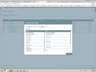

CSVWriter Properties
Avro Schema

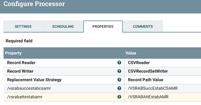

Add change the added dynamic properties in update record processor as shown below:
/vsrabsuccestabcsamr
/VSRABSuccEstabCSAMR
/vsrabattestabamr
/VSRABAttEstabAMR
As we swapping the data to lower case, so keep the lowercase field names as property name and upper lower mix filed name as property value.
Then processor will add the field value to the newly added field names.

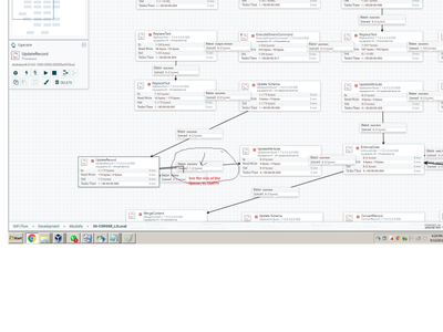

Re: NiFi: Convert data into lower case
@Shu
pmresult-67109368-60-201804260000-201804260100-ori.zip (Please unzip, its a csv file)
sample-xml.xml
Same result :-(. Also attaching XML and Source data file for testing.
Empty Queue

I attached the sample flow template that I have tried update-record-222899.xml .Use the attached flow xml as a reference and change per your case.
