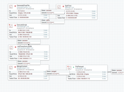

I want to transform JSON to Parquet, i followed a tutorial and my current flow is functionally.
My problem is that i need to create parquet schema's dynamically. Every schema needs to get generated reading attributes/content of the incoming flowfile. Putparquet processor uses a RecordReader. I found this processor called ScriptedReader but i have no idea about how i can generate a schema and use it for PutParquet processor. Does anyone now how to use it? Or, are there any alternatives about creating a schema dynamically for Putparquet processor?
