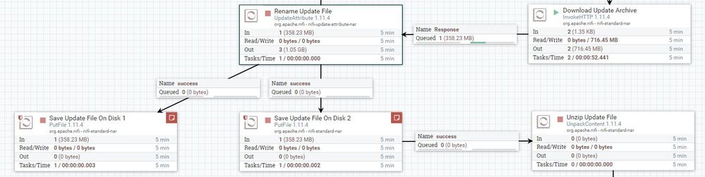

In my NiFi workflow I need to download .zip file from SOAP web-server, save it on machine (optional) and unpack content to sub-folder. Everything works on my local Win 10 machine, but issues occur when I try to move to remote Linux server. Here is the part of my flow when error happens:
So we have a FlowFile entered UpdateAttribute where filename attributed is set with required name and .zip extension. The file is correct as can be seen in queue after starting the processor.
