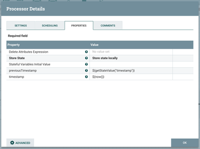

You should be able to do this using an UpdateAttribute with the state feature. You can add an UpdateAttribute to the flow:
And configure it as follows:
This way, each flow file going to InvokeHttp will have two attributes:
- Timestamp : the current time
- previousTimestamp : the time of the previous execution. You can use this in your InvokeHttp.

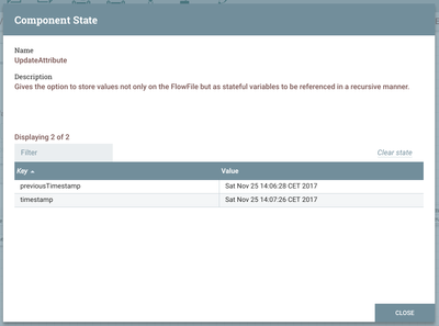

Here's an example of attributes that InvokeHttp will have access to (in my case I execute this every minute as you can see)
Is this what you are looking for?
