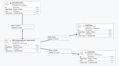

I want to stop a processor on the same machine with restApi but I get an authorization error when I call the rest api.I can solve this problem with bearer token, but since the token has expired, I need to change the bearer token manually again.Is there a way I can authorize automatically?
- I am using the executeScript processor when calling the API.Script engine is Groovy.
- My Nifi version 1.23.2 and Nifi is secure and not clustered.I login with ldap on UI.
This is the part where I call the API in the script:
def post = new URL(NifiBaseUrl.value + NifiComponentId.value).openConnection();
post.setSSLSocketFactory(sslContext.getSocketFactory())
post.setRequestMethod("PUT")
post.setDoOutput(true)
post.setRequestProperty("Content-Type", "application/json")
post.getOutputStream().write(content.getBytes("UTF-8"));
post.getResponseCode()

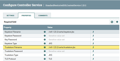

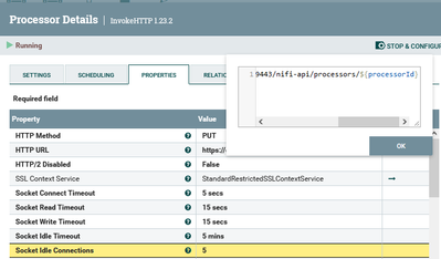

As I said, nifi is secure and authenticates via ldap when logging into the frontend.
I defined StandartRestrictedSslContextService on controller services.StandardRestrictedSslContextService uses the trustStore and keyStore files I created before. The same files are defined in nifi.properties.
When I call the API with invokeHttp using this service, I get the following error:Unable to modify Components requiring additional permission: execute code. Contact the system administrator.
If I send a userToken with the authorization parameter to the invokeHttp processor, I get a successful response.
Since using userToken complicates the flow, it would be better to use SSL service.But I have no idea how to overcome the error I shared above.
