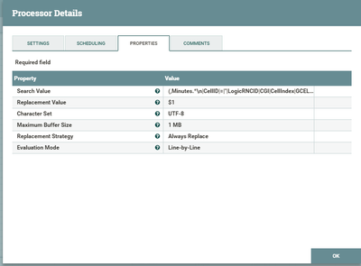

I am using NiFi replacetext processor to delete some strings in csv file but somehow its not working.
Below is the search string:
(,Minutes.*\n|CellID|=|"|LogicRNCID|CGI|CellIndex|GCELL:LABEL)
below is snapshot:
Can anyone tell how to mention multiple string in search box and how to mention delete these in replacement value.

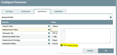

Change the replace text Replacement Strategy to Regex Replace because you are using "|"(or operator) to search for all the possible instances in your input csv file by using Evaluation mode as Line-By-Line and change the Replacement value property to empty string.
Always Replace will replace the entire flowfile contents based on Evaluation mode property <value> without searching for any value.

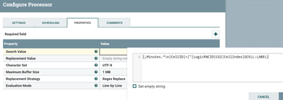

ReplaceText Configs:-
Replacement Value as empty string
Search Value
Replacement Value
Empty string set //we are searching for all the values above and replacing them with empty string
Regex Replace //interprets search value as regex and replaces matched value with replacement values
Evaluation Mode
Line-by-Line //Run the 'Replacement Strategy' against each line separately (Line-by-Line)
