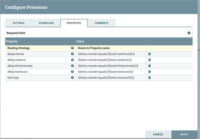

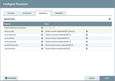

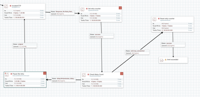

You could use the UpdateAttribute and RouteOnAttribute processors to create additional attributes on the flow file that keep track on the number of times the file has looped on a particular relationship. Here is an example of a flow that keep track of every relationship but the original flow file in the InvokeHttp processor:
Here is the configuration of the UpdateAttribute processor
The advanced UI in the RouteOnAttribute can be used to set the delay time using an attribute
Here is the configuration of the RouteOnAttribute processor

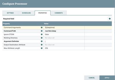

The delay is done using the ExecuteStreamCommand processor and calling the sleep command with the appropriate value to wait for the next attempt in using the InvokeHttp processor.

In ExecuteStreamCommand processor command path= ' usr/bin/sleep' what is this thing because i am getting exception in ExecuteStreamCommand processor .."The System cannot find the file specified"
and i am using windows

That is a command in Unix, to wait the amount of time specified, 30 seconds, one minute whatever is specified. The Windows equivalent is timeout I believe, so just replace the command.

usr/bin/sleep is seem a directory structure
so i have to replace usr/bin/sleep to timeout only
or something else can you give me an example

Correct, just replace /usr/bin/sleep with timeout.
What version of Windows are you using?

windows 10 version 1703

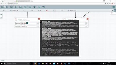

but now after replacing to timeout i am getting error invalid value for timeout(/T) specified .valid range id -1 to 9999

i getting this error now

i am using your template
and now it is firing after every 30 sec for 5 counts
InvokeHTTP Penalty Duration is 30 sec as per my requirement everything is in your template already but it is not working as i want to
