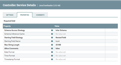

What you need is JsonTreeReader service instead where its configured to use Nested Field as Starting Field Strategy, then specify "book" as the Starting Field Name, as follows:
