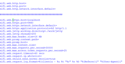

nifi.properties
# We recommend configuring HTTPS instead. The administrators guide provides instructions on how to do this.
nifi.web.http.host=localhost
nifi.web.http.port=8080
nifi.web.http.network.interface.default=
#nifi.web.https.host=localhost
#nifi.web.https.port=8443
nifi.web.https.network.interface.default=
nifi.web.https.application.protocols=h2 http/1.1
nifi.web.jetty.working.directory=./work/jetty
nifi.web.jetty.threads=200
nifi.web.max.header.size=16 KB
nifi.web.proxy.context.path=
nifi.web.proxy.host=
nifi.web.max.content.size=
nifi.web.max.requests.per.second=30000

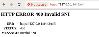

Master Mentor
@PepeVo
"When I set the ip address (not localhost) on nifi.web.https.hosts and connect it with error "the proxy server is refusing connections".  Do I need to set the nifi.web.proxy.host to ipaddress too?"
This because the IP does not exist in a SAN in your certificate.   The first step here is create a proper clientAuth certificate that includes the SAN entries and EKUs.
Apache NiFI out-of-the-box would have created a proper format keystore certificate.
The CN value in the certificate is typically the hostname of the server it is being used on.  I've seen multiple different value snippets in what has been shared by you.
That hostname you are trying to use in the NiFi URL must exist as a SAN entry in the certificate. (This is not a NiFi specific requirement, this is enforced by the JDK)

I tried to connect and after accepted the risk, the browser with 400 error

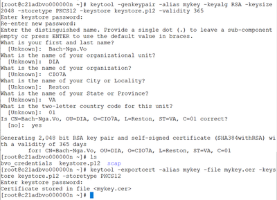

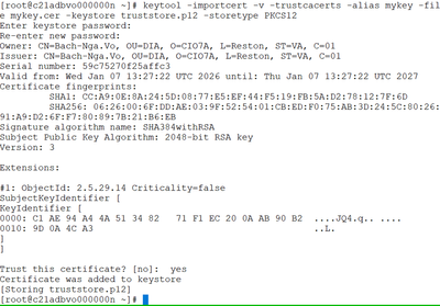

I don't see any LISTEN running.  Just regenerate the keystore and truststore and will try to update nifi.properties, hopefully it works.

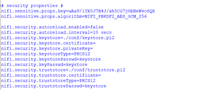

i generate a new keystore and truststore, modified nifi.properties and still can't start the application.

I see the process nifi is still running but can't connect after accepting the risk.  using chrome and/or firefox

nifi.properties

The invalid SNI is not a NiFi thing.  It is related to trying to use 127.0.0.1 local IP in the URL.  You are going to need to use a hostname.
I see in you set https.host=localhost in the nifi.properties.  Is "localhost" a SAN entry in the certificate?
Can you share the verbose output from the NiFi generated keystore and the keystore you manually created?  The NiFi generated keystore should have SAN entry for localhost and your server/computer hostname.

keystore:
truststore:
I don't know how to check "localhost" a SAN entry in the certificate?  I will check with my colleague for the output.

 when I generate the keystore
I set on /etc/hosts
still not bring the ui up
