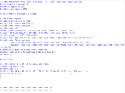

Look at the output from following java keytool command:
keytool -v -list -keystore <nifi-keystore.p12/jks
You'll want to verify the EKU, KeyUsage, and SubjectAlternativeName (SAN) fields in the output.
EKU must contain clientAuth and serverAuth
SAN must contain your server hostname and any other hostname your node may also be known as.  One of these SAN names is what you must use in the browser URL.
Hostname verification in the TLS exchange between your browser and NiFi is done using the certificate SAN and not the Certificate DN.
You also can add the same IP address (127.0.0.1) to the /etc/hosts file multiple times.  it will resolve to the first entry.   If you want to assign additional names to 127.0.0.1, it needs to be done on same line.  But SNI is not going to allow you to use 127.0.0.1 in the browser URL.
You should set the "nifi.web.https.host" property in the nifi.properties file to one of the SAN values from your keytstore and then use that name in your url to access the NiFi UI.

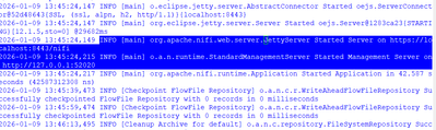

On NiFi startup, you can also tail the nifi-app.log looking for the line that looks like this:
... [main] org.apache.nifi.web.server.JettyServer Started Server on https://<hostname>:8443/nifi

Thank you for instruction and I don't see any EKU, KeyUsage, and SubjectAlternativeName (SAN) fields in the output.
in the nifi-app.log I do see " g.apache.nifi.web.server.JettyServer Started Server on https://localhost:8443/nifi "
but still can't start the ui by using the host ip address or hostname, I get the "secure connection failed",  if I connect it using localhost/127.0.0.1 I still get "400 Invalid SNI" (I heard to commented that SNI is not going to allow you to use 127.0.0.1 in the browser URL, but I am trying to see if I get the same error)

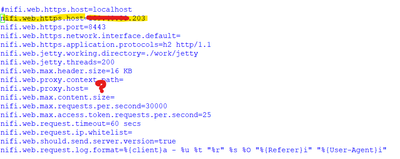

When I set the ip address (not localhost) on nifi.web.https.hosts and connect it with error "the proxy server is refusing connections".  Do I need to set the nifi.web.proxy.host to ipaddress too?

"When I set the ip address (not localhost) on nifi.web.https.hosts and connect it with error "the proxy server is refusing connections".  Do I need to set the nifi.web.proxy.host to ipaddress too?"
This because the IP does not exist in a SAN in your certificate.   The first step here is create a proper clientAuth certificate that includes the SAN entries and EKUs.
Apache NiFI out-of-the-box would have created a proper format keystore certificate.
The CN value in the certificate is typically the hostname of the server it is being used on.  I've seen multiple different value snippets in what has been shared by you.
That hostname you are trying to use in the NiFi URL must exist as a SAN entry in the certificate. (This is not a NiFi specific requirement, this is enforced by the JDK)
