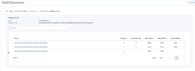

We are facing an issue, where preprod Nifi server is able to read a kafka topic correctly.
It is able to read all 3 partitions data.
At the same time UAT Nifi server is connecting to same topic with different consumer group id and which is reading only the partition 0 & partition 1 but not partition 2.
Screen shot from Lenses abt the same consumer group which is facing issue
Any idea what could be the possible reasons?

Master Collaborator
Thanks for the quick reply @MattWho .
We found the issue.
It was due to firewall setup for the partition-2 on broker side.
When they fixed it started working
