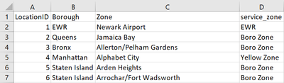

Hi @aakulov
Fiirst picture is example of .xlsx file, second picture is what I get, and third what I want to get.
Did you mean first to convert excel to csv with comma delimiter, and then to use ReplaceText to replace comma with broken pipe? I don’t have broken pipe in excel file, why to use ReplaceText on original .xlsx file first?

Frequent Visitor
Yes, ReplaceText processor helps. First I convert to csv with regular pipe as delimiter, and after that I replace it with broken pipe.
