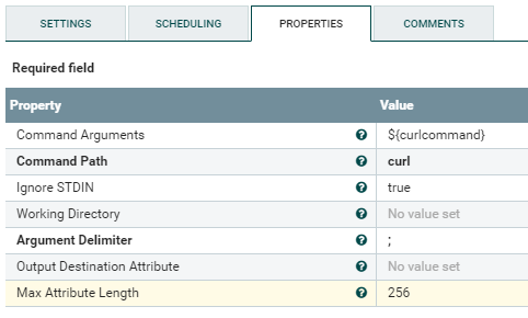

I am using execute stream command processor to make a curl call to rest api and getting below json parse exception.
Curl Call: (below command was extracted into a variable called curlcommand as mentioned in the screenshot)
--location;--request;POST;"https://abc.com/data";--header;${content_type};-d;"[{"bin": "02608","groupId": "52821094"},{"bin": "02609","groupId": "528212387"}]"
Exception:
{"timestamp":1580154052402,"status":400,"error":"Bad Request","message":"JSON parse error: Unexpected character ('b' (code 98)): was expecting double-quote to start field name; nested exception is com.fasterxml.jackson.databind.JsonMappingException: Unexpected character ('b' (code 98)): was expecting double-quote to start field name\n at [Source: (PushbackInputStream); line: 1, column: 2] (through reference chain: java.util.ArrayList[0])","path":"/data"}
Please help..

What is your NiFi Version?
Looks like there is already a similar JIRA [1]  Which seems to be addressing this behaviour of "ExecuteStreamCommand" in the NiFi version "1.10.0".
[1] ExecuteStreamCommand filters out any double quotes when parsing the "Command Arguments"
     https://issues.apache.org/jira/browse/NIFI-3221

@jsensharma Thanks for your response.
We are using 1.7.
I changed ExecuteStreamCommand to InvokeHTTP processor.
