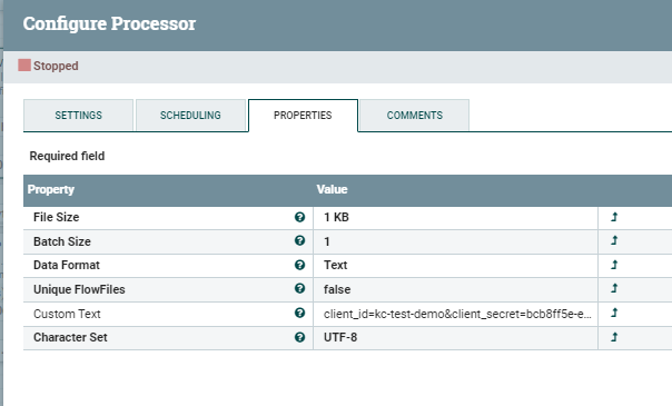

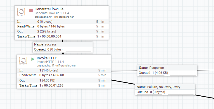

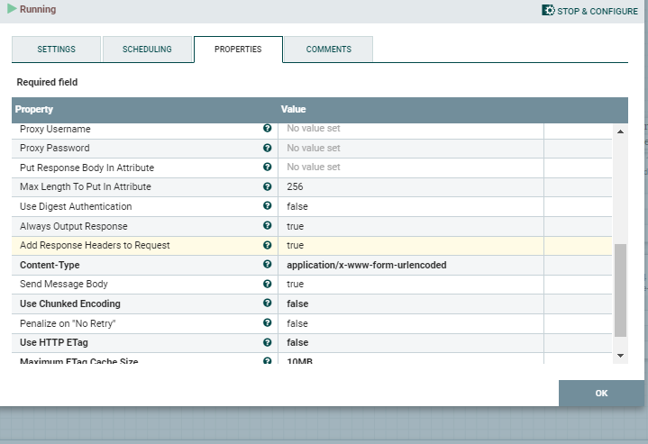

Explorer
Attached is the screenshot for the solution
E2E  FlowE2E FlowGenerate Flow FileGenerate Flow FileInvokeHttp.InvokeHttp.
