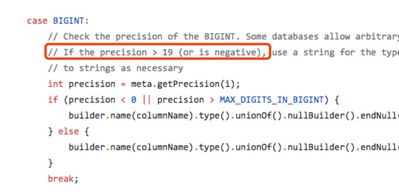

As your answer,I noticed the nifi BigInt problem. It`s true that "if the percision>19, it will be changed into string".
the process happened in the "QueryDatabaseTable" processor.
I read the source code, and find the function which they write to dell with the jdbc data.
#QueryDatabaseTable https://github.com/apache/nifi/blob/master/nifi-nar-bundles/nifi-standard-bundle/nifi-standard-proce... #QueryDatabaseTable import this class for data process https://github.com/apache/nifi/blob/master/nifi-nar-bundles/nifi-standard-bundle/nifi-standard-proce...
jdbcCommon.java
Tanks a lot for your help~
But I don't know how to solve the problem gently, I might just use the String format in Hive.
There also some place should notice, they deal the "TinyInt" and "Boolean" with the same way.The value "0" or "1" will be change into "false"/"true".
