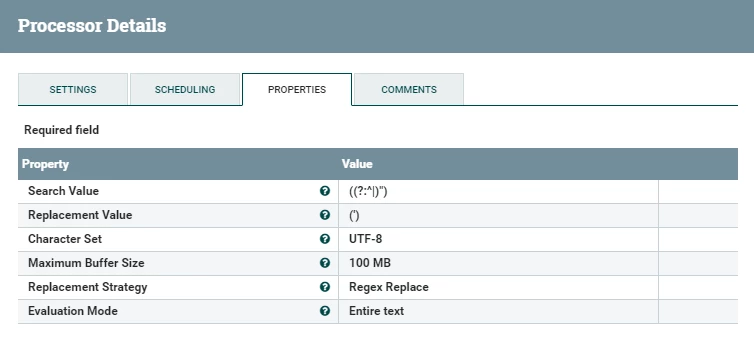

@Venkatesh AV
Just want to make sure we are using correct processor for what you want to do:
The ReplaceText processor is used to replaceText in the content of the FlowFile.
The UpdateAttribute processor could be used to replace text contained within an attribute of a FlowFile.
Assuming the FlowFile content is where you want to replace double quote with single quote, the following ReplaceText processor configuration will do that for you:

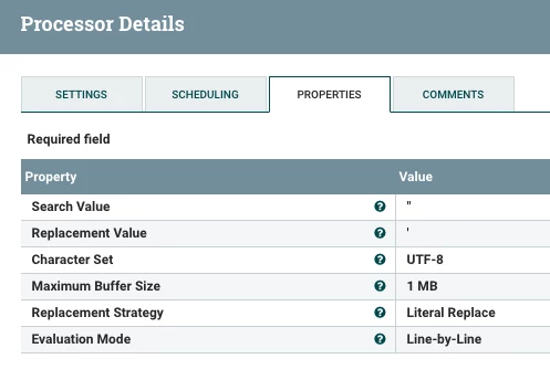

@Venkatesh AV
