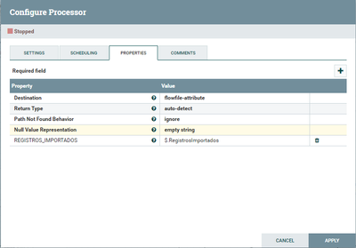

ReplaceText =
EvaluateJsonPath =
This is Response Before Replace Text =

Master Mentor
@leandrolinof
The "EvaluateJsonPath" processor you shared has the configured destination as a FlowFile-Attribute and thus leaves the content of the FlowFile unchanged.
So if FlowFile Attribute is where you want this parsed output to reside, you could use "ExtractText" [1] as an alternative solution.
The used value here would be:
.*Erros":\[(.*)\].*
This has only 1 capture group which is for the content you are trying to extract.  That content is then added to the FlowFile in a new FlowFile attribute based on the property name.
If you instead want to replace the content of your FlowFile with only the portion of the original content you are trying to extract, you could use the "ReplaceText" [2] processor.
The used Java regex "Search value" here would be:
(.*Erros":\[)(.*)(\].*$)
Which breaks source content into 3 capture groups so regex matches entire content and capture group 2 matches on the string output you are looking for.
So "Replacement Value" is simply set to "$2" so that entire content is replaced with just contents of capture group 2.

Contributor
@MattWho
Thanks for the time available for my problem, the "ExtractText" worked perfectly for my case and the data was saved in my database.
