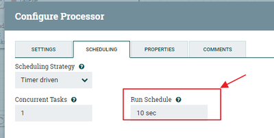

TailFile SCHEDULING like following ;
Scheduling Strategy => Timer driven
Run Schedule => 10 sec ( also we have tried 1 min )

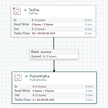

Nifi does not schedule TailFile job ( maybe all processors ) itself.

In the screenshot, TailFile Task/Time is shown as 30 (times) in the last 5 min (300 secs). If you scheduled TailFile to run every 10 sec, I think the stats is correct. It seems TailFile is scheduled correctly but there hasn't been new lines found so no FlowFile is produced by TailFile.
When new lines are added to the file that being watched by the TailFile, those will be picked up by TailFile and passed to PublishKafka.
If you're sure that new lines are appended but not seeing any data is ingested to NiFi, then please elaborate the issue.
