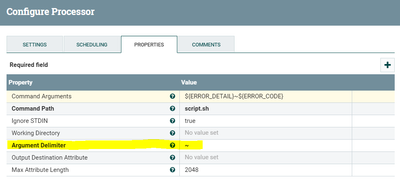

I'm having issues with ExecuteStreamCommand, I have set up the Argument Delimiter as ~ like screenshot below:
However when ERROR_DETAIL attribute contains newline characters (\n or %0A) apparently Nifi treats the newline as a delimiter and hence the shell script receives more than 1 arguments in the place of ERROR_DETAIL. I was expecting Nifi to use strictly just the ~ character as the argument delimiter.
Am I missing a different config in Nifi? Is there a way to make Nifi ignores the newline and only use the ~ as the delimiter?

Hi @araujo , thanks for your suggestion.
I tried doing that, and while it seems to make Nifi ignores the newlines indeed, the processor now throws a different error:
ERROR: ORA-01756: quoted string not properly terminated
The strings are definitely terminated in the configuration.... The ERROR_DETAIL does contain double quotes as well, can this be affecting it?

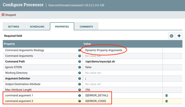

Super Guru
Hi, @abvincita ,
Please ignore my last post. I did a quick test using dynamic properties arguments and confirmed that it works well, regardless of the content of the attributes.
Please give this a try:
