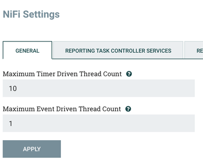

NiFi uses CPU for its core level functions and then you configure an additional thread pool that is used by the NiFi components you add to the NiFi canvas.  This resource pool is configured via NiFi UI --> Global Menu (upper right corner of UI) --> Controller Settings:
The "Event Driven" thread pool is experimental and deprecated and is used by processors configured to use the event driven scheduling strategy.  Stay away from this scheduling strategy.
The "Timer Driven" thread pool is used by controller services, reporting tasks, processors, etc... The Processors will use it when configured to use the "Timer Driven" or "Cron driven" scheduling strategies.
This pool is what is available for the NiFi controller to hand out to all processors requesting time to execute.   Setting this value to an arbitrarily high value will simply lead to many NiFi components getting threads to execute but then spending excessive time in CPU wait as the time on the limited cores is time sliced across all active threads.  The general rule of thumb here is to set the pool to 2 to 4 times the number of available core on a single NiFi host/node.  So for your 8 core server, you would want this between 16 and 32.  This does not mean you can't set this higher, but should only do this in smaller increments while monitoring CPU usage over extended period of time.  If you have 5 nodes, this setting is per node so you would have a thread pool of 16 - 32 on each NiFi host/node.
