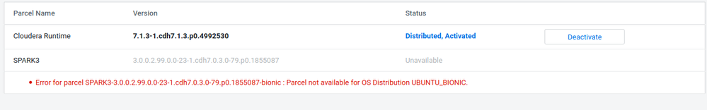

I have a 18.04 bionic cluster using the Cloudera Manager 7.1.3 and CDH 7.1.3 parcels.
I need to install CDS3 (Spark 3.0.0) on my cluster but I can't find any parcels for the bionic version, only xenial, wheezy and trusty.
Does it exist? Can you also publish it for bionic?
Thank you !!

@Cluster-CDP I can see bionic parcels as well.
Please make sure you are using the correct document and method to install the Spark. Follow below doc:
https://docs.cloudera.com/runtime/7.2.7/cds-3/topics/spark-spark-3-packaging.html
https://docs.cloudera.com/runtime/7.2.7/cds-3/topics/spark-install-spark-3-parcel.html
