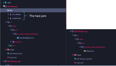

I am running into a problem with deploying a custom controller service to NiFi (I am using the latest version of NIfi 1.12 as of writing this). Now what I am trying to do is to create a custom controller service that would allow me to access a Virtuoso DB instance (similarly to DBCPConnectionPool). This controller relies on 2 external jar files (provided by Virtuoso) that I have placed inside a /libs folder under the module that implements the interface of my service. I have pointed to these jars as dependencies in the pom.xml of that same module and maven is able to import them. Furthermore, I am able to successfully compile and run a JUnit test of my implementation of the service which consists of simply getting a connection and checking if it is open.
The problem arises when I compile my service into a NAR and then deploy that service in NiFi. NiFi is able to detect it but when I try to enable it, it throws a NoClassDefFoundError that is related to these external jars. Now I am considering doing similarly to DBCPConnectionPool and create a property to point to these jars and load them externally, however, I simply do not understand what is causing the problem and I am too curious to let it go, I am also concerned that this approach may not be viable for these jars. So i am curious if someone can point me in the right way.
Here is my folder structure:

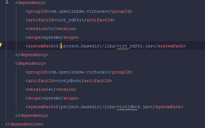

Here is the pom where/how I declare the jar dependencies (This is where I am assuming the error might be)

An update since I managed to solve the issue. I followed the advice given in this StackOverflow post https://stackoverflow.com/questions/364114/can-i-add-jars-to-maven-2-build-classpath-without-install... by creating a static in-project repository so that maven can have better access to the jars. It seemed to do the trick.
