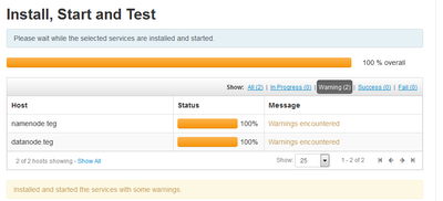

I have lost track of the number of unsuccessful attempts at the deployment through the console. All requisites, such as selinux disabled, THS, ntp sync, password less sync from master node (amari server) to data node, etc are fine.
  1. I once again got a Java Process warning, after hosts were successfully registered, on the masternode.
    Process Issues (1) The following process should not be running /usr/lib/jvm/jre/bin/java -classpath
  2. Warnings on namenode - end to end. No warning messages were shown
  3. Failures on the datanode, right from DataNode Install Help please!
    Thanks

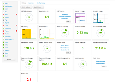

Namenode: Oozie server start and warnings thereafter till the end
OOzie server start
Traceback (most recent call last):

File/Dir does no exist: /etc/tomcat/conf/ssl/server.xml
                      stdout:    /var/lib/ambari-agent/data/output-164.txt

Datanode: Warning from flume start and check flume end . No logs were posted for these two
Expert Contributor
The status as of now is :
Hive - Webcat server
Oozie - as per the error above.issue with ssl and https.
Falcon - falcon server
flume - no error or warning but on the data node.
I look forward to comments/recommendations please.

setting CATALINA_BASE=${CATALINA_BASE:-/usr/hdp/current/oozie-server/oozie-server}
setting CATALINA_TMPDIR=${CATALINA_TMPDIR:-/var/tmp/oozie}
setting OOZIE_CATALINA_HOME=/usr/lib/bigtop-tomcat
It did however refer to /etc/tomcat. We had configurations settings at .bashrc, /etc/profile and /etc/init.d/tomcat re-Catalina Base and Catalina_Home.
The oozie-setup.sh has references to Catalina_Base in many places. This may be the reason why it was referring to the wrong path.
Solution:
Code walk through on the shell files of oozie and other services, which did not start.
Commented references to Catalina_Home and Catalina_Base in /etc/profile and etc/init/d/tomcat.
Impact:
All hadoop services have started
