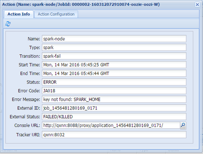

I recently tried spark action with Oozie and end up getting the following error:
My job.properties file:

Created 03-14-2016 06:22 AM
- Mark as New
- Bookmark
- Subscribe
- Mute
- Subscribe to RSS Feed
- Permalink
Can you please share your HDP version? Also it looks like this issue is similar to oozie bug https://issues.apache.org/jira/browse/OOZIE-2482.
Created 03-14-2016 11:29 AM
- Mark as New
- Bookmark
- Subscribe
- Mute
- Permalink
oozie spark action is not supported in HDP 2.4 and earlier. We have it stated in release notes and Spark user guide.
