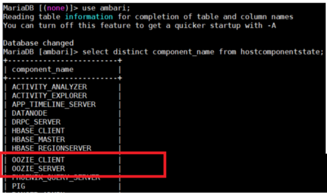

When you delete components at times you leave the database in an inconsistent  status. you will need to log onto the Ambari Database to do some manual cleaning.
There are 3 important tables that hold the component status
  • hostcomponentstate
  • hostcomponentdesiredstate
  • servicecomponentdesiredstate
A  targeted select on the component name to show , run the below  to check if your oozie components are still
[root@nakuru ~]# psql ambari ambari
Password for user ambari: #default password is "bigdata"
psql (8.4.20)
Type
"help" for help.
ambari=> select distinct component_name from hostcomponentstate;
If you see the oozie components in the databases then you will have to delete those entries, I have  used 'OOZIE_SERVER','OOZIE_CLIENT' in the below example

You can then stop all the components in the  cluster and restart the database, you might need to restart some stale configurations  that might have been orphaned  due to the removal of the oozie components
HTH
