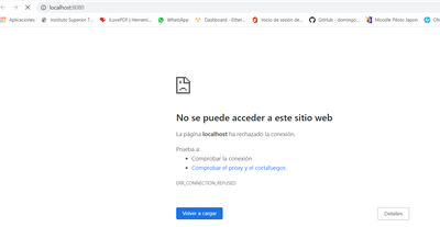

And finally to desplegate Ambari i have this error
Please help i need your help, thanks
