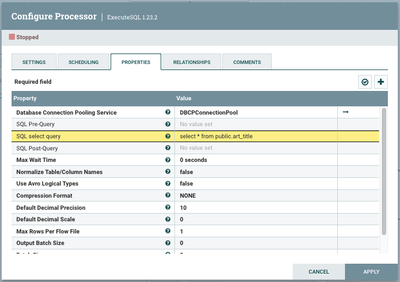

Is there only 500 records in your table and that is all the records you want to processes? If so then you dont need to create schedule , you can run it once using the query  in the "SQL Select Query" property:
select * from public.art_title
If you use the ExecuteSQLRecord then you can set the RecordWriter to Json using JsonRecordSetWriter, or XML using XMLRecordSetWriter to get the needed format, this way you save yourself having to convert from Avro to Json then Json to XML. You can get the result in XML right way.
Also if you set the property "Max Rows Per FlowFile" to 1 , then it will create only one record per flowfile so there is no need to split.

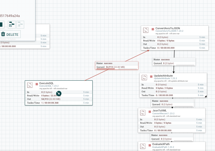

but it looks like still a lot of information, not only 500 flowfiles in the queue. Above pic is my configuration.Screenshot 2023-12-14 at 9.17.29 AM.png

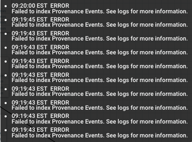

By the way , on the upper right corner of NiFi page, there are some errors that I can't understand. Can you explain it to me? Thank you so much!!!

I need to understand the following:
1- Does the table have total of 500 records and if so are those records static or are they going to be modified over time and you need to keep processing them ?
2- Do you need to run the ExecuteSQL multiple times to process the same\updated 500 records or do you just need to process them once ? each run of ExecuteSQL with the provided select query will fetch the total records, so if you start the processor to start running indefinitly where the Run Schedule under the Scheduling tab is set to 0 then it will keep fetching the same total records again and again and it will fill up the queue .

1. These data is static and there are only 500 rows in the table. I don't need to modify them in the future and I don't need to keep processing them. I only need to get all 500 rows from table and then done.
2. I just need to process them once. Do I need to set the schedule time longer so that the ExecuteSQL only process once and this once will contain 500 rows?
